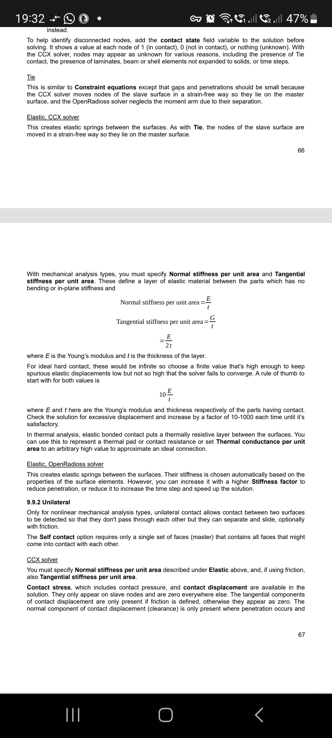

I come from a Strand7 background which uses a very different formulation for contact compared to CCX. What is the easiest way to estimate the contact stiffness in a model?
Something like K = E/H where H would possibly the average length of an element...
Have you take a look at Mortar contact?. I have obtain clearanes of 1E-35 with reasonable times. There is some limitations due to units conversion but results are really good when it works.
No, I did not know about that, but I will definitely look into it as 1E-35 is approximately zero for all intents and purposes, so it would definitely help me better aproximate the contacts of gear faces. I'll try that out soon and see what can be concluded from it.
