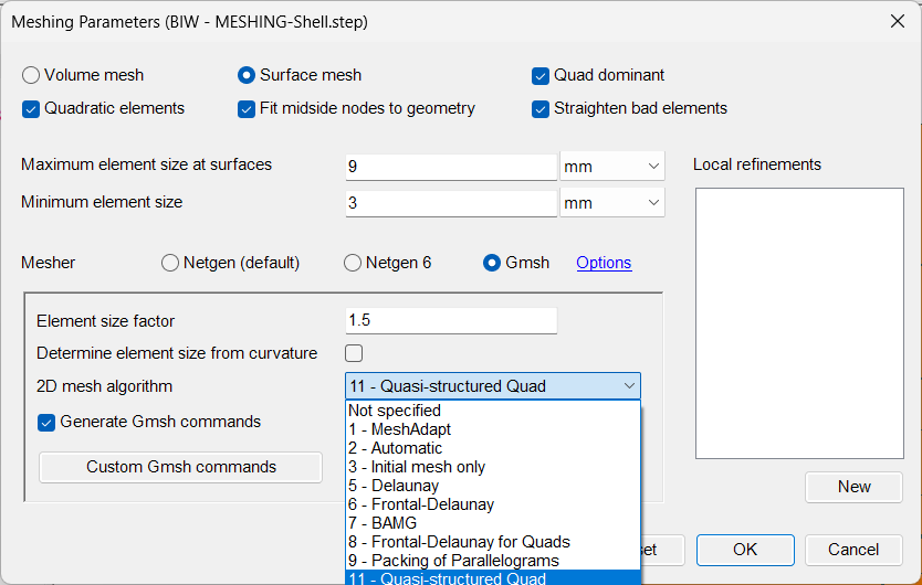

GmshSetting for Mesh.Algorithm (2D mesh algorithm). Default is now 2 (automatic) which often gives better element shapes than not specifying it.
