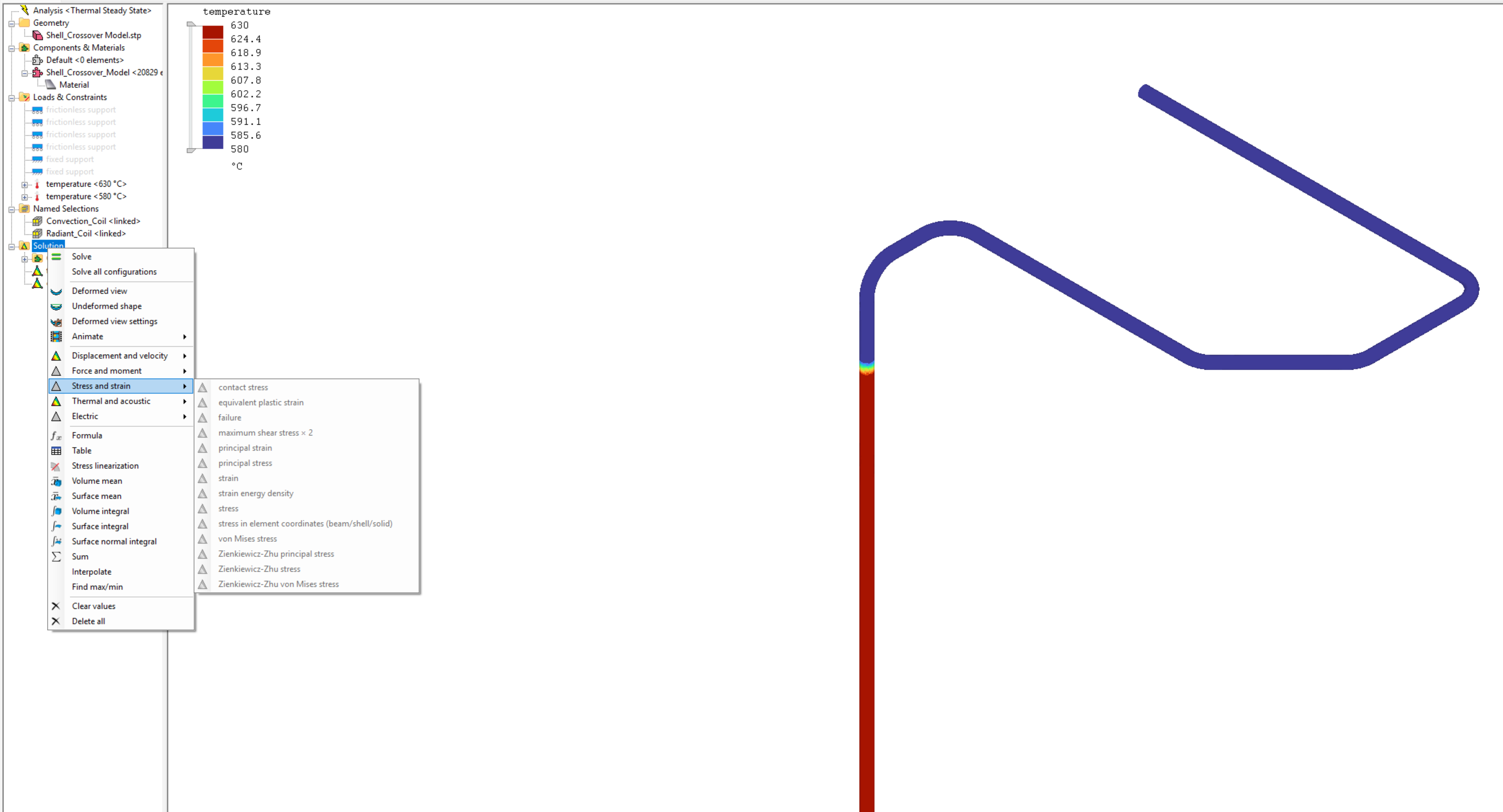

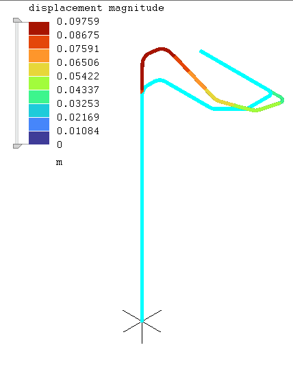

I am trying to use Mecway in place of a pipe stress program in order to find the reaction forces on some pipe supports. The temperatures modeled a the nodes "should" produce thermal displacements, but for some reason they don't. With solids and meshed models I have been able to get results before, but this seems to be a new challenge changing to line elements.
Are there things that i can do that would allow the program to solve for thermal movements? It would be way easier on my side to do this with line elements than to build it in shells and locate everything everything.

  • Yes, beam elements work with thermal stress.
    Your screenshot shows analysis type is thermal, so change it to static which has displacement DOFs. That's also why many of the boundary conditions are shown in red, which means error (displacement constraints aren't valid for thermal analysis type).

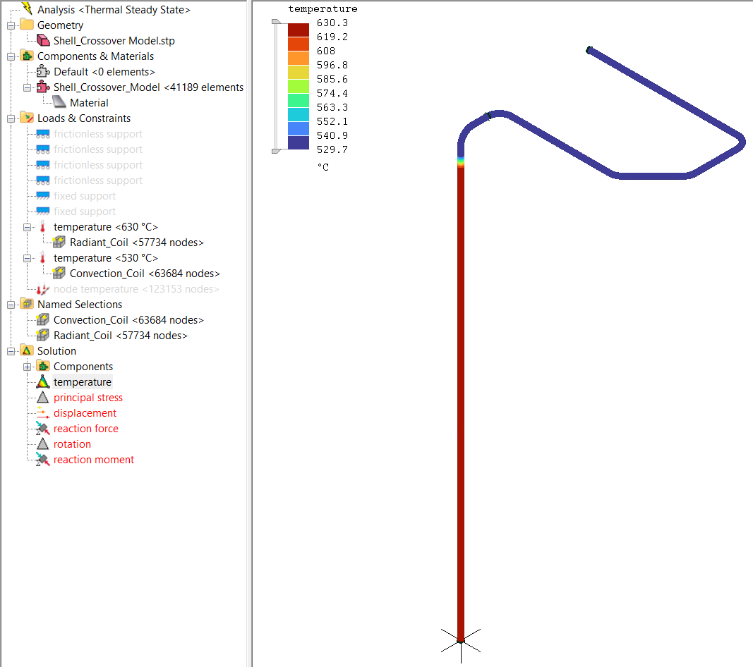

    I rebuilt the model out of shells, in case they are able to behave differently. I could not get the temperatures to drive displacements, which would then drive reaction forces. I exported the temperatures on all nodes, but it still did not produce displacements.
    Please advise if shells are able to produce thermal displacements, then please let me know. The model screenshot attached did not produce displacements.
  • Yes, shells can too. Could you post the .liml file and I can identify all the problems.
    I notice there's no thermal stress item in Loads & Constraints. You need to include that when you do the static solve.
  • I should also add that items displayed in red text in the outline tree have errors. To see what it is, right click it and pick What's wrong? Items with orange text are warnings which are also worth looking at if something's not working right.

    I cannot get anything beyond temperature, heat flux, and contact from the thermal steady state solver. The model and some screen shots are attached.

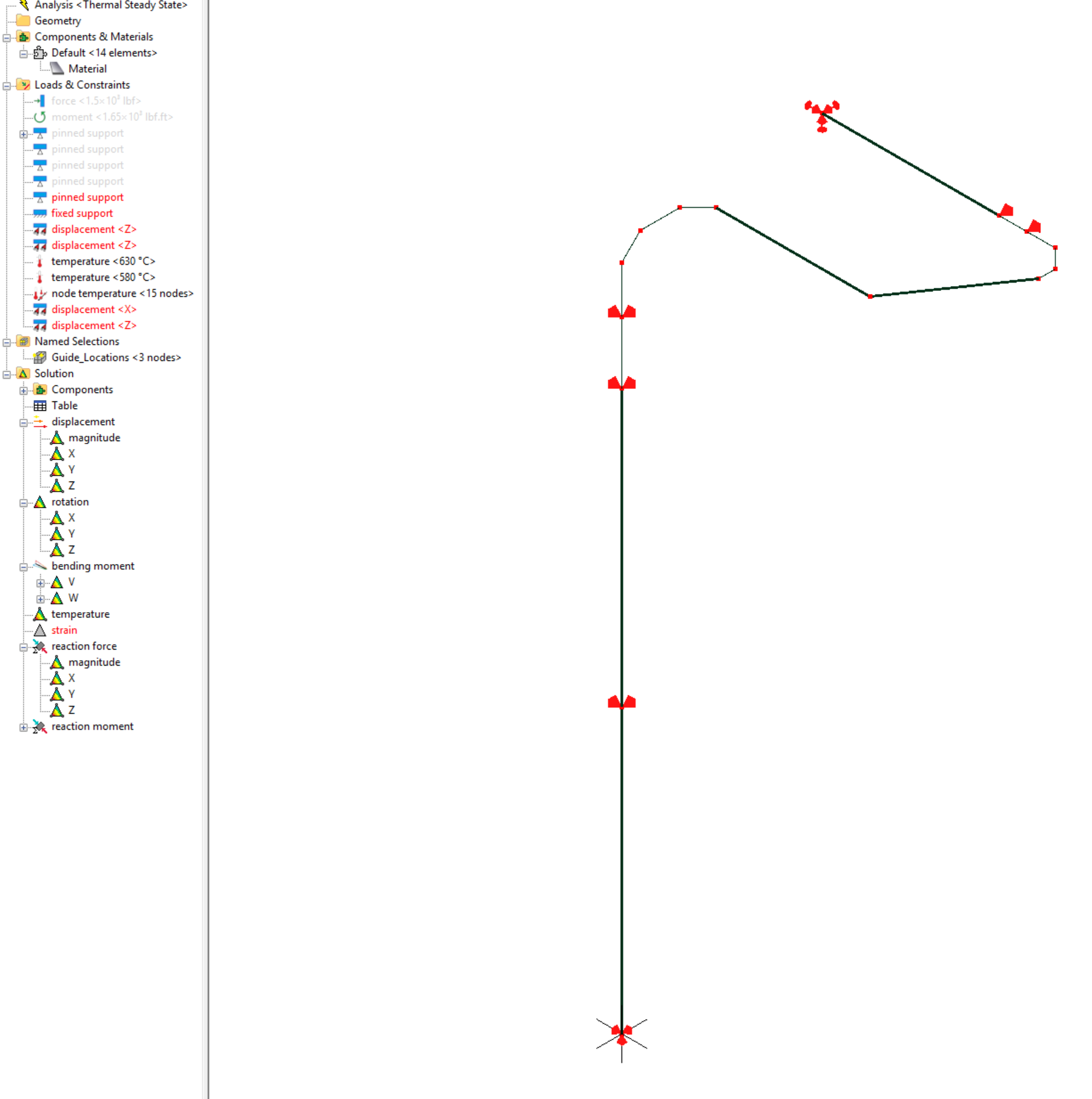

    Change your analysis type to static 3d, unsuppress the frictionless suports, add a thermal stress bc, in the solution branch request displacements, stresses and reactions forces and solve again. Could you please upload/share the beam model and the reference results maybe?

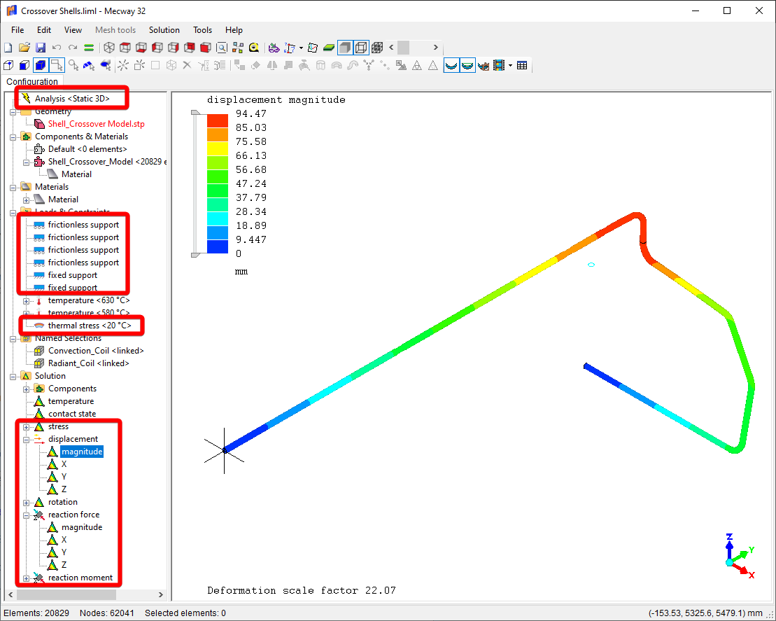

  • I made 4 changes:
    - Set the analysis type to Static 3D.
    - Unsuppressed the mechanical constraints.
    - Added a thermal stress item. I chose 0°C as the Reference temperature so you might have to change that.

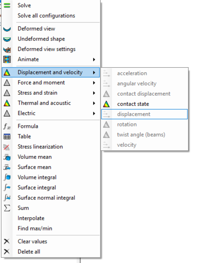

    - Added displacement and reaction force to the solution using the same menus you showed in your last post. They are no longer disabled since analysis type has been set to Static 3D where they're valid.

    Per your request, the line model is attached. I have messed with this model quite a bit trying to get it to do what i wanted it to.
    The other thing that would seem to be really useful if i continue to use Mecway for pipe stress would be the ability to add a gap to a restraint. I could always figure out which way the node moves and force the elimination of the gap through a displacement, but it seems like a rough way to go for every guide. Thermal displacements on the shells obliviously worked, but line elements cannot do that.
    At some point i will probably get Ceasar II or similar pipe stress software, but so far i am really pleased with what Mecway is able to do, even with the corners that i had to cut like forced displacements on cold pipe (which added its own inaccuracies).

  • For the beam model, just add a thermal stress item and unsuppress the temperatures.
  • Thanks Victor. Those 2 little steps did it for me for the beam model.
