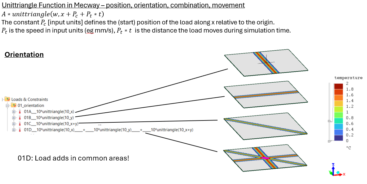

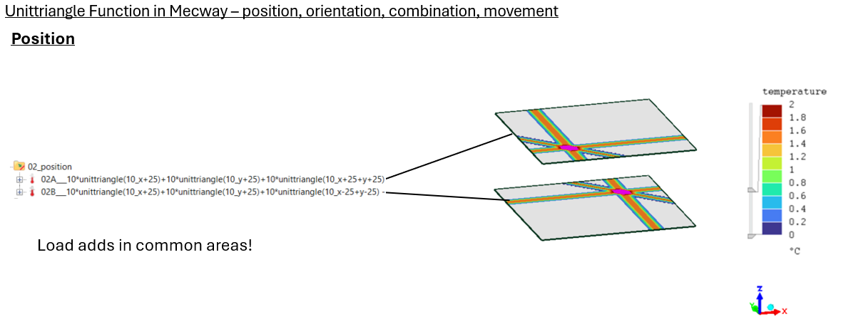

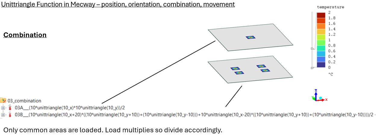

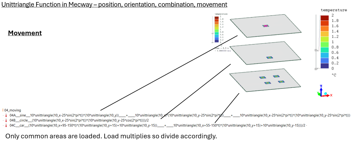

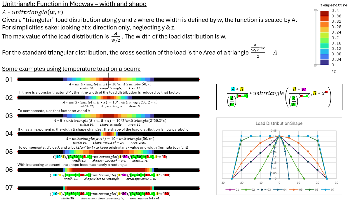

recently I had to deal with moving loads for a project. I used the unittriangle function for that but I was not quite sure what unittriangle actually does or can do.
Therfore I went onto al little expedition into the undergrowth of unittrianlge, trying to figure it out.
For anyone who is interested, I share my expedition journal. There might be mistakes and/or flaws, so be careful if you want to use any of it.
One of the main discoveries was, that the shape of the function is not always triangular. It can also have a parabola shape or it can also be nearly reactangular.
