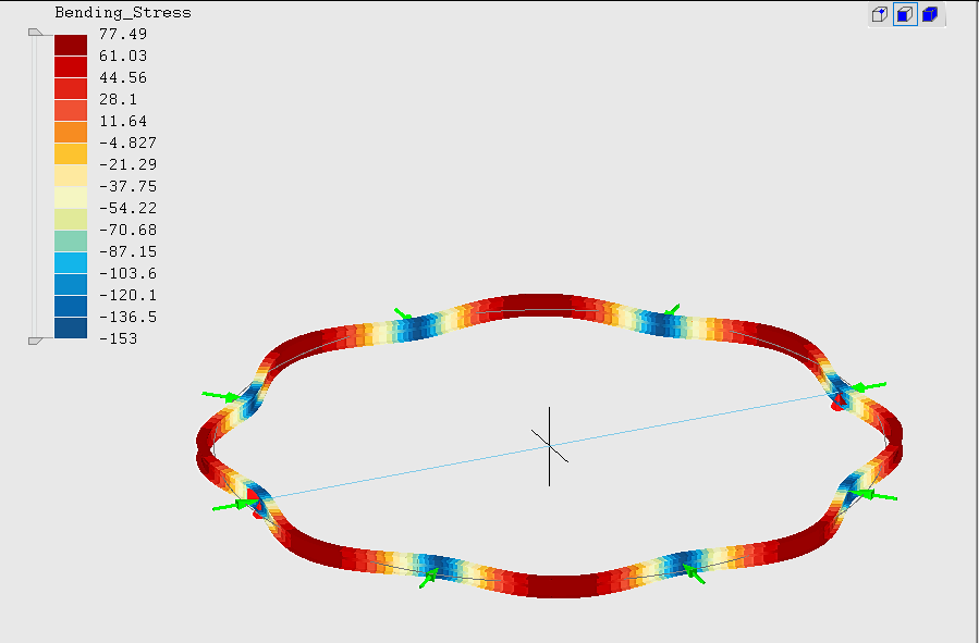

    Appart from that, I just finished a small Mecway template for our team to be able to check compression Rings and Crowns and agreement with hand calculation is more than excelent. All main expected axial loads, moments, compressive and bending stresses agreed really well. Maximum deflections not as good as expected but I'm reviwing my hand calcs.
