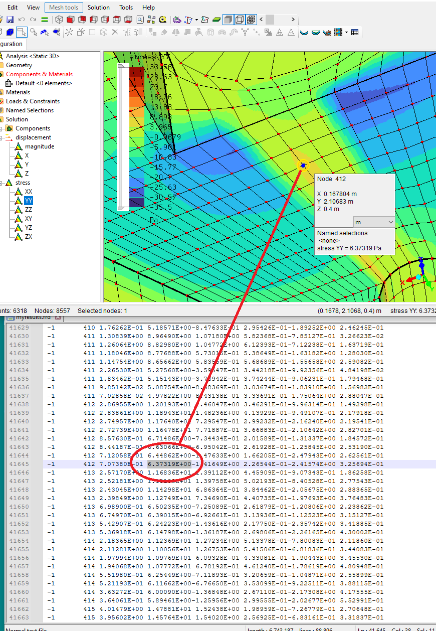

calculix .frd format is readable, and I had tried to change my results data to this format. Please find attached following message when Mecway read my.frd data, and I am sure this is in the right format. Thank you. :
Field of length 5 missing at column 74 of line
-2 5 21 25 9 6 22 26 10
Context:
3C 6318 1
-1 1 1 0 1
-2 1 17 21 5 2 18 22 6
-1 2 1 0 1
-2 17 33 37 21 18 34 38 22
-1 3 1 0 1
-2 33 49 53 37 34 50 54 38
-1 4 1 0 1
-1 5 1 0 1
EDIT: I just noticed there are multiple values for each node, as you can see in the listing below. That must be the problem.
